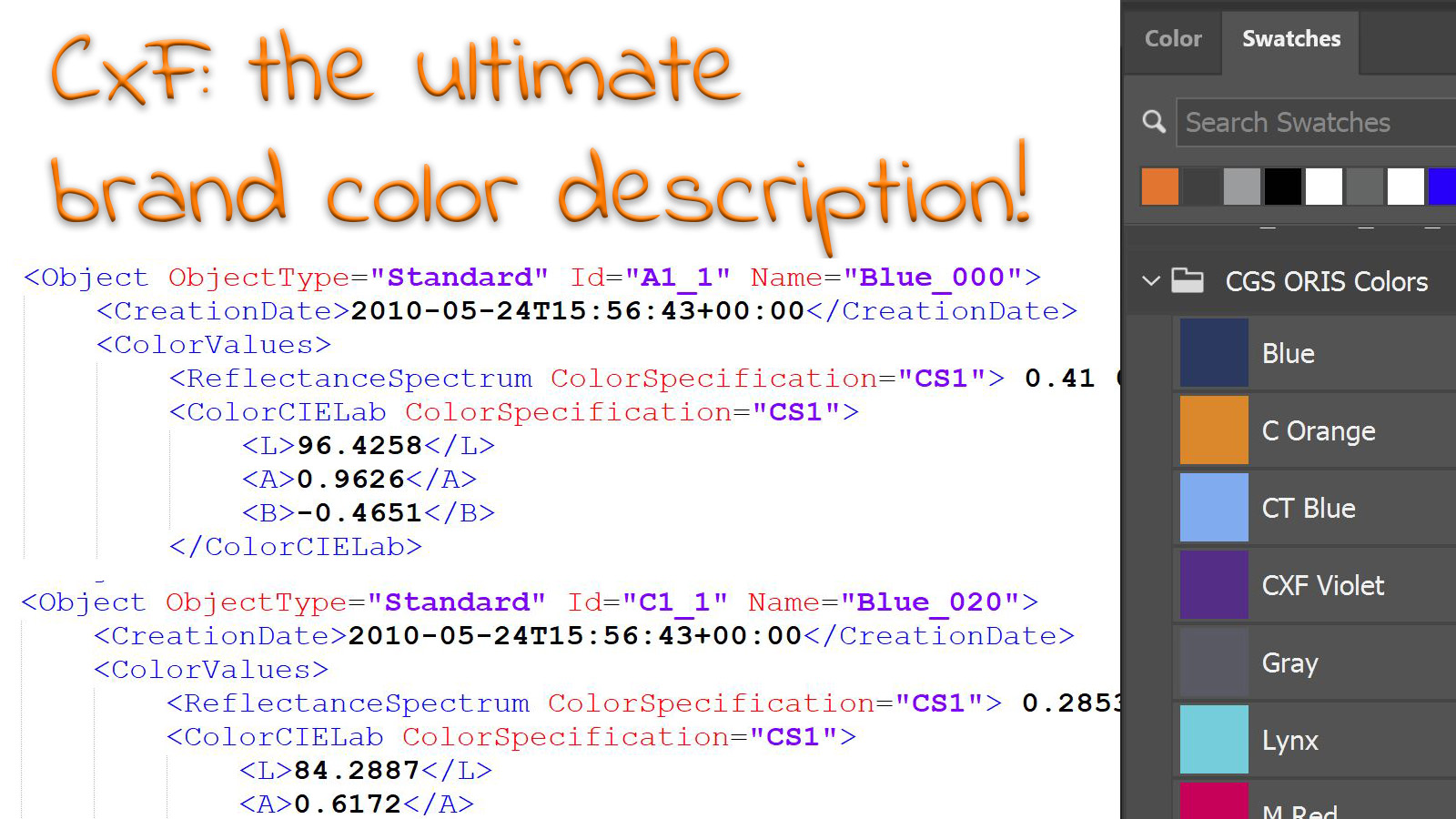

I think it is important to emphasize that for people who own an Xrite/Calibrite measurement device, they
still can download Pantone Color Manager and get L* a* b* representations for the various fan deck colors. The Xrite/Calibrite measurement device acts like a license dongle for Pantone Color Manager.
Pantone Color Manager is also capable of saving out the entire contents of a given fan deck as CXF, ACB, ACO, and ASE files.

In the end, the point is that you can get the information you need to have up to date swatches for Adobe and Affinity applications. Sadly, Coreldraw does not process ACB files correctly and has no intention of addressing the problem by either correcting their defective ACB file processing or adding the ability to use ASE files… I know because I asked.

But with the new PDF 2.0 specification and CXF spectral datas, my guess is all software developper are going to push on this way, rather than continue maintaining Spot Colors with CMYK and lab values. Only using Pantone is an historical Graphic Designer matter.
My two cents.
What you mention about PDF 2 and CXF spectral data may not be relevant to the practical reality of implementing proper spot/brand/named color reproduction at the RIP level. Most RIPs with which I am familiar are setup to allow you to use Lab*, and then bind a Lab* specification to an ICC profile-driven ink build or enable you to bind a custom ink build that may come from a tool like Colorant or Colorpicker in order to get a better color match.
