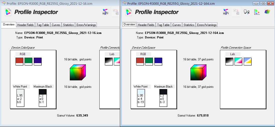

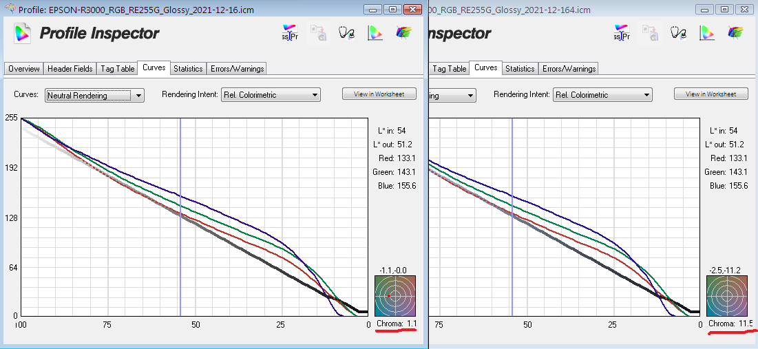

Hello, does ColorThink v3.0.5 work correct with ICC v4 printer profiles. I mean the curves Neutral rendering Chroma is showing bluish cast and nonsense values. Profile built with i1profiler

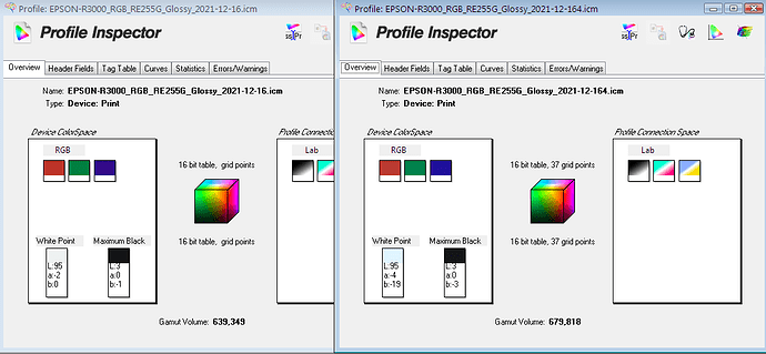

The wtpt tag in the profile will specify the “White Point” values you see in the Overview tab
V2
Blockquote
XYZ: 0.8422699, 0.88346863, 0.72975159
Lab: 95.3068007, -1.8068409, -0.0617904
LCH: 95.3068007, 1.8078972, 181.9586408
Yxy: 0.8834686, 0.343015, 0.3597932
Luv: 95.3068007, 0.2069008, 0.4882974
5100B0K
Blockquote
V4
Blockquote
5100B0K
Blockquote
The D65 was selected for both profiles. Tags look the same. Why they are shown different, bug in Colorthink?

Hi Joe,
I’ve been able to confirm the problem on Windows. It’s related to the CMM used in ColorThink and some version 4 profiles.
Interestingly, it doesn’t happen in the Mac version even though the code and (in theory) the CMM are the same…
So thanks for the heads up. We’ll work on a fix
